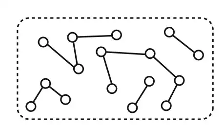

A 1-factor is a perfect matching. A path factor of a graph $G$ is a spanning subgraph, each of whose components is a path with at least two vertices (see the following figure).
Since every path with at least four vertices has a $\{P_2,P_3\}$-factor, a graph has a path factor if and only if $G$ has a $\{P_2,P_3\}$-factor.
