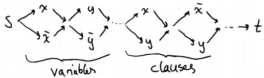

It's NP-hard with a single source and a single target, and looking for a single path.
Reduction from SAT. Let $\phi = C_1 \land C_2$ where $C_1 = x \lor y$ and $C_2 = \neg x \lor y$.
See attached picture. There is a path collecting exactly #variables many attributes if and only if $\phi$ is satisfiable.
In the example, you can find an $s$-$t$-path collecting exactly two attributes, the ones corresponding to your chosen truth assignment. Notice that if you in the start choose to visit $\neg y$, you need to visit three attributes.
Reduction from SAT
