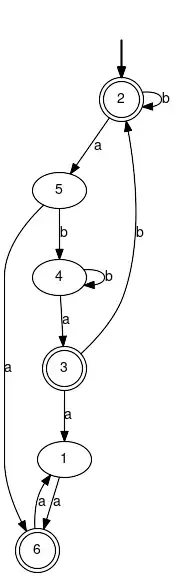

Hint: Here is an automaton for this language
Gribouillis
  • 204
