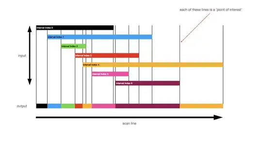

I found an answer that works well. The basic concept is to iterate a sorted list of all 'points of interest' (start and end location of intervals). Iterating that (scan line) allows us to maintain a stack of 'active intervals' (push when interval starts; pop when interval ends) where the top one is the dominating interval. That will essentially give us a list of non-overlapping segments associated with the dominating interval. That is exactly the goal.
visualisation of the algorithm
In slightly more detail (hope I got the text description about right):
  1. Create an array of all intervals which are already sorted by start point in $O(n)$.
  2. Initialize:
    1. An empty hash set of 'dead intervals' in $O(1)$.
    2. An empty stack of 'active intervals' in $O(1)$.
    3. An empty array of 'output intervals' in $O(1)$.
  3. Create a 'points of interest' array of all start and end points of all the intervals alongside the kind (start/end) and index (into the array of all intervals) in $O(n)$.
  4. Sort the 'points of interest' array by position/index/kind in $O(n \log n)$.
  5. Run a scan line from front to back: Iterate through the 'points of interest' from front to back in $O(n)$. For each 'point of interest' do:
    1. If it's a start point:
      1. Add the interval (looked up by index) to the stack of 'active intervals' in $O(1)$.
      2. If we have previously remembered an 'open interval', close it and append it to the array of 'output intervals'. Also clear the remembered 'open interval' in $O(1)$.
      3. Remember the current position as 'open interval' in $O(1)$.
    2. If it's an end point:
      1. Add the interval (looked up by index) to the set of 'dead intervals' in $O(1)$.
      2. While the interval at the top of the 'active intervals' is contained in the set of 'dead intervals' in amortized $O(1)$ (this can be $O(n)$ but each interval can only be in the dead intervals once):
        1. Remove from 'dead intervals' in $O(1)$.
        2. Pop the stack in $O(1)$.
      3. If we have previously remembered an 'open interval', close it and append it to the array of 'output intervals'. Also clear the remembered 'open interval' in $O(1)$.
      4. If the stack of 'active intervals' is non-empty, remember the current position as an 'open interval' in $O(1)$.
Overall, the algorithm runs in $O(n \log n)$.
