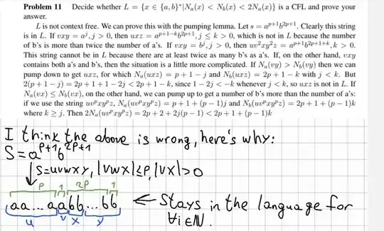

I've been working on proving that this language
L = {x ∈ {a, b}∗ | na(x) < nb(x) < 2na(x)}
is not Context Free. "na(x)" stands for "number of a's in the string x".
I however can't find a string where all possible divisions of the string can be pumped out of the language. For example, I tried a^(p+1) b^(2p+1), but I can pick the last a and the first two b's and pump them however I like, without the string exiting the language.
I attached an image with the full text of the exercise and why I think that the provided solution is wrong.
What am I missing here? Also, if the language actually is free, what would be the context free grammar for it?
The language is context-free. Slightly different: Context free grammar construction $\{ a^mb^n \mid m≤n≤2m \}$.
For strings where the symbols $a,b$ may be in any order, you might find inspiration in the language $\{w∈\{a,b\}^∗:\#_a(w)=2\#_b(w)\}$.

As the other answers indicate, the language is indeed context-free.
Writing a grammar for it is a bit tricky, but we can do it as follows.

$N_a(x) \lt N_b(x) \lt 2N_a(x)$
OK, finally, the language we're actually interested in.
Observe that we must have $N_a(x) \ge 2$, otherwise there's no valid value for $N_b(x)$. So $N_a(x) \ge 2$ and $N_b(x) \ge 3$, and the condition $N_a(x) < N_b(x) < 2N_a(x)$ can be written as $N_a(x) - 2 \le N_b(x) - 3 \le 2(N_a(x) - 2)$. This means that an element of this language can be thought of as an element of the prior language plus 2 extra a's and 3 extra b's. (Please take a moment to convince yourself of this.)
What's more, with the exception of bbaaabb, any string in this language must have a substring of length 5 that contains exactly 2 a's and 3 b's. This is because:
  • As we've seen, it must have length at least 5, which means it must have at least one substring of length 5.
  • If it has a length-5 substring with fewer than 2 a's and a length-5 substring with more than 2 a's, then it must have a length-5 substring with exactly 2 a's, because consecutive same-length substrings overlap in all but one character, so their number of a's can differ by at most one. (For example, aaaaabbbbb contains the substring aabbb on its way from aaaaa to bbbbb.)
  • If all of its substrings have fewer than 2 a's, then it has least 4 b's between any two a's, which means it has at least two b's per a, which is not allowed.
  • If all of its substrings have more than 2 a's, then . . . this case is a bit trickier. Let's write its length as 5m + k, where k is in {0,1,2,3,4}. The first 5m characters contain at least 3m a's and at most 2m b's, so they leave a deficit of at least m + 1 b's; so the last k characters need at least m + 1 more b's than a's. Since m is at least 1, and the last k characters can have at most 2 b's, the only solution is m = 1, k = 2 (for a total of 7 characters), with both of those last two characters being b's. Applying the same logic from the right end of the string, we find that the first two characters must also be b's, and the overall string must be bbaaabb.
This means that (1) any string from this language can be formed by inserting either bbaaabb or a permutation of aaabb somewhere in a string from the prior language (W), and (2) conversely, a string formed by doing that will be a string from this language.
Let's label those eleven possible insertions (bbaaabb and the ten permutations of aaabb) with the nonterminal I:

Suppose that instead of a stack, you had a single counter, $x$, that you could either increment or decrement, under the control of a non-deterministic finite-state machine. (Each transition of the finite-state machine either increments $x$, decrements $x$, or leaves it unchanged.)
Can you think of how to recognize the language with such a machine?
Hint:
When you see a b, decrement $x$. When you see an a, non-deterministically either ____ or _____. You fill in the blanks.
Can you think about how to convert such a machine into a pushdown automaton? (It is known that they can be converted -- these machines are called one-counter machines, which are known to be equivalent to pushdown automata.)
Hint:
Somehow encode the value of $x$ on the stack. What are reasonable options for how you might represent an integer?
You might take a look at Context free grammar construction for inspiration and ideas.
You'll have to fill in the details, as it is your exercise.
