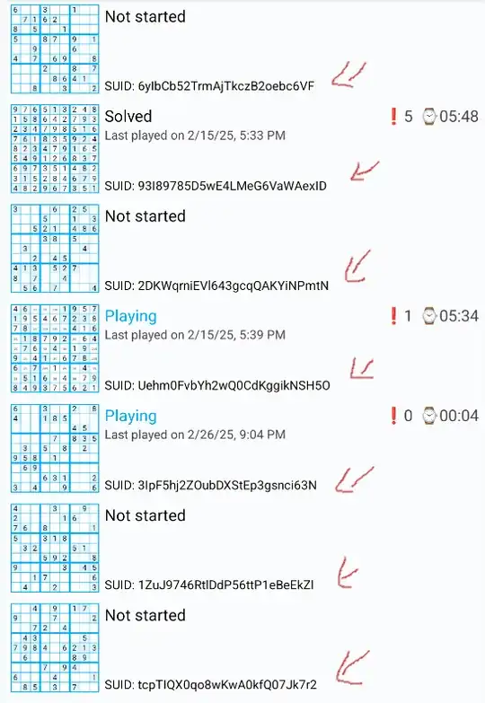

I've implemented pretty simple yet efficient encoding of normal Sudoku puzzles. On average it encodes any solution to 72.9 bits of data (this statistical value is calculated on a 120117 puzzles probe).
The logic is quite simple: Calculate the number of possible values for each cell ('possible' assessment uses simple Sudoku rules: unique digit per row, column and box) after any next value inserted, select the first of least count of possible values and store it in a BigInteger variable (to store it multiplies the current value index by total possible values count for the current cell and add the index to the encoded BigInteger).
Thanks to the fact that this logic can be reversed during decoding it works flawlessly.
To include any valid game state information it uses additional 81 bits value (one bit for each cell). So to represent any valid Sudoku state it uses 153.9 bits on average in total. It is also converted to an alphanumerical string to show it in game. enter image description here
Improvements: I have also implemented a bit ( literally :D ) more efficient algorithm which was using DLX to check what are the really possible values for each cells at any stage of encoding. It was though way more expensive on resources and the gain was usually only 1 bit. It was working, it's just not quick enough for use inside the Android game.
Another improvement (as suggested elsewhere) would be to use the fact that the minimum required cells do define a solution is 17. And again, the gain seems too small to bother.
I've released the implementation in the Open Sudoku project which I'm authoring since version 4. The code is available here (the game is on GPLv3 license). You can take a look. Please let me know if you find any improvement that is not-heavy on resources.
