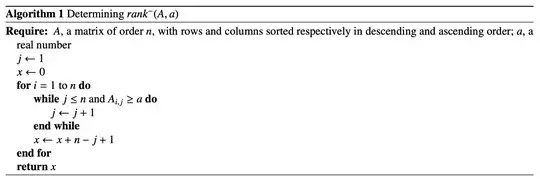

Determining $rank^-(A,a)$ can be done in $O(n)$ taking advantage of the fact that the rows and columns of $A$ are sorted respectively in descending and ascending order. Algorithm 1 shows how to compute $rank^-(A,a)$. Similarly, $rank^+(A,a)$ can be determined in $O(n)$ as well.

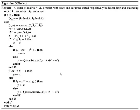

To select the $k$th item, the algorithm determines two items $a$ and $b$ with $a \geq b$ from $\overline{A}$. Letting $z$ denote the $k$th order statistic of $A$, the algorithm ensures that (i) $b \leq z \leq a$ and (ii) the number of items of $A$ whose value is less than $a$ and greater than $b$ is $O(n)$. The function MAselect (Mirzaian and Arjomandi Select), shown in pseudocode as Algorithm 2, determines the $k$th item of $A$ in $O(n)$.
MAselect simply calls the biselect function (Algorithm 3) with parameters $s$, $A$, $k_1$ and $k_2$, with $k_1 \geq k_2$. The pair $(x, y)$ is returned, so that $x$ is the $k_1$th item of $A$ whilst $y$ is the $k_2$th item.
Defining
$\overline{k_1} = \begin{cases} n + 1 + \lceil \frac{1}{4} k_1 \rceil & \quad \text{if } n \text{ is even}\\ \lceil \frac{1}{4} k_1 + 2 n + 1 \rceil & \quad \text{if } n \text{ is odd} \end{cases}$
and
$\overline{k_2}=\left\lfloor\frac{1}{4}\left(\mathrm{k}_{2}+3\right)\right\rfloor$
$\overline{k_1}$ is the smallest integer such that the $\overline{k_1}$th item of $\overline{A}$ is at least as large as the $k_1$th item of $A$, and $\overline{k_2}$ is the largest integer such that the $\overline{k_2}$th item of $\overline{A}$ is no larger than the $k_2$th item of $A$.
The QuickSelect algorithm is Hoare's selection algorithm, which works in expected $O(n)$ time.
