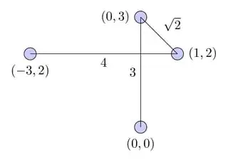

For example, in the graph below, you want to go from $(0,0) \rightarrow (-3,2)$. Normally, an algorithm like Dijkstra's algorithm would produce a sequence like:
$$\left[ (0,0) \stackrel {3}{\rightarrow} (0,3) \stackrel{\sqrt{2}}{\rightarrow} (1,2) \stackrel{4}{\rightarrow} (-3,2) \right] = 7+\sqrt{2}.$$

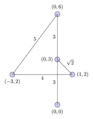

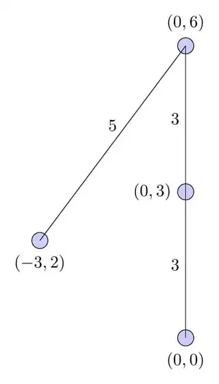

However, this path intersects itself on the euclidean plane, therefore I want an algorithm that would give me the shortest non-intersecting sequence, in this case:
$$\left[(0,0) \stackrel{3}{\rightarrow} (0,3) \stackrel{3}{\rightarrow} (0,6) \stackrel{5}{\rightarrow} (-3,2) \right] = 11.$$
This path is longer than the shortest path, but it is the shortest non-intersecting path.

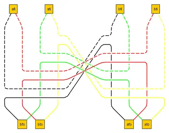

The basic idea behind the crossing is to prepare a path for each pair of wire points and bend the possible paths enough so that all pairs except those that encode the same logic (compatible paths) cross each other. Of course we can't just say two parallel edges intersect, but we can introduce extra order-2 nodes to make two paths intersect.
Supposing the paths come from north to west and from south to east, we can: collect each path from north with its compatible path from east on a line (some incompatible paths will cross each other); cross each pair with each other by reversing the order of pairs; distribute the paths to their south and west endpoints. This is best explained by a diagram. Here, each pair of nodes represents a wire point. Paths with the same color code (carrying the same logic) don't intersect, paths a different color code do:
graphical depiction of the above

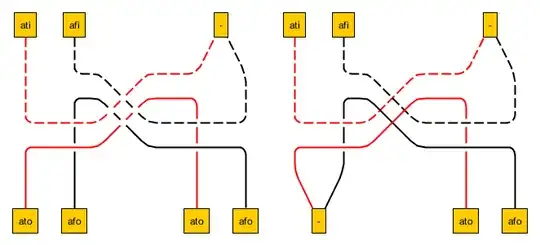

The branch point and the vertical wire work the same, but there are fewer paths to correlate:
two pairs of paths are sufficient here. The wire is essentially a branch point with the branch destroyed

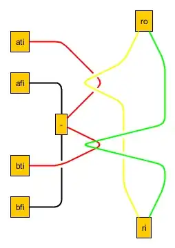

The clause box follows the same logic: each literal exposes one of its paths to the reading wire, then converging to the south (if it's the northernmost term or the term to the north converges to the north) or to the north (if the term to the north converges to the south). The reading wire (one node at the endpoints) branches to become one path per literal. Each reading path then crosses the literal's true-path if the literal is negated, the false-path if it is not. Note that the converged path may or may not cross a clause boundary. For consistency, here's a diagram for $\neg A \vee \neg B$:
