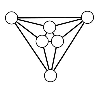

This is more of a comment, but I want to append an image. The following graph is maximal planar and every node has degree 4, thus the proposed algorithm does not work. The maximal independent set of this graph has 2 nodes.
graph
As I said, this is more of a comment / not an answer.
