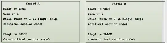

I have seen this C code showing an implentation of Peterson's Critical Section algorithm. It is obviously skeletal and hardwired for two threads but the logic is supposed to be correct in detail.
Peterson's algorithm in pseudocode
Despite reading and talking I remain with a grain of doubt about the following line (and the similar line for Thread B):
`while (turn == 1 && flag1) skip;
When it is compiled, the while clause will generate multiple instructions which it seems to me can lead to a race condition in a pre-emptive scheduling model.
While I trust the proofs etc. I have not seen a good way to refute my concern.
This is the technical beauty of Peterson's algorithm. Even though there could be many possible execution paths for this short and simple-looking code, it guarantees mutual exclusion, progress and bounded waiting. (Bounded waiting is not guaranteed for more than two participating threads, though).
On first sight, it looks there is a race condition on which thread will set the value of "turn", especially in a pre-emptive scheduling model. However, a close analysis will show neither does this race condition corrupt the mutual exclusion nor does it prevent progress. Here is the basic analysis on mutual exclusion by Wikipedia, adapted for the variable names here.
Thread A and Thread B can never be in their critical sections at the same time. If Thread A is in its critical section, then flag0 is TRUE. In addition,
  • either flag1 is FALSE, meaning that Thread B has left its critical section,
  • or turn is 0, meaning that Thread B is just now trying to enter its critical section, but graciously waiting,
  • or Thread B is right before the line turn = 0, trying to enter its critical section, after setting flag1 to TRUE but before setting turn to 0 and busy waiting.
So if both threads are in their critical sections, then we conclude that the state must satisfy flag0 and flag1 and turn = 0 and turn = 1. No state can satisfy both turn = 0 and turn = 1, so there can be no state where both threads are in their critical sections.
Note that the analysis above is programming-language independent. It does not matter you use C, Java, Python, assembly, etc.
Note that the analysis above only assumes that the code/instruction in each thread is executed/implemented serially. Whether there is a race condition to set turn or whether the scheduling model is pre-emptive does not matter.
