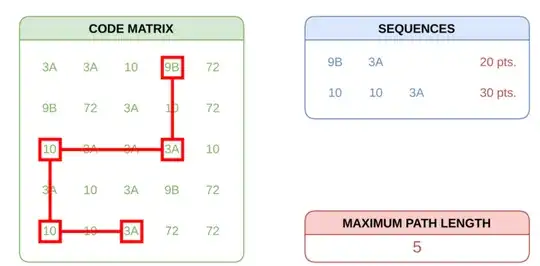

For example: enter image description here
The task is to find the shortest path, if possible in the graph that contains one or more sequences with the highest total score and the path's length is not exceed the provided maximum length.

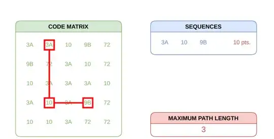

The picture below demonstrates the solved puzzle with the resulting path marked in red:
Here, we have a path 3A-10-9B. This path contains the given sequence 3A-10-9B so, which earns 10pts. More complex graphs typically have longer paths containing various sequences at once.

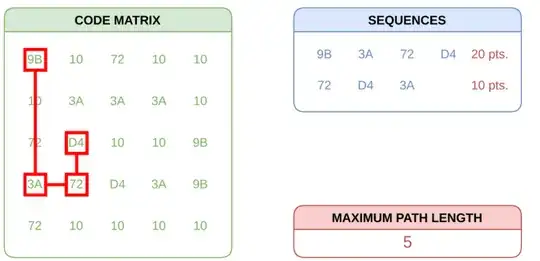

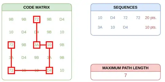

Here, we must waste one move before the sequence 3A-9B and two moves between sequences 3A-9B and 72-D4. Also, notice how red lines between 3A and 9B as well as between 72 and D4 "cross" previously selected cells D4 and 9B, respectively. You can pick different cells from the same row or column multiple times.

In the above example, we can complete either 9B-3A-72-D4 or 72-D4-3A but not both due to the maximum path length of 5 cells. We have chosen the sequence 9B-3A-72-D4 since it grants more score points than 72-D4-3A.

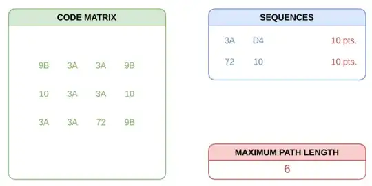

Unsolvable solution
The first sequence 3A-D4 can't be completed since the code matrix doesn't contain code D4 at all. The second sequence, 72-10, can't be completed for another reason: codes 72 and 10 aren't located in the same row or column anywhere in the matrix and, therefore, can't form a sequence.
