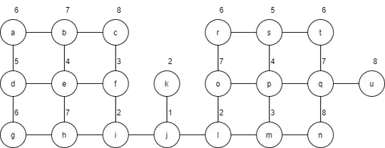

Consider the graph from the question, labelled
Labelled graph
Consider the DFS traversal a-b-c-f-e-d-g-h-i-j-k-l-m-n-q-p-o-r-s-t-u with a recursion depth of 19. The numbers represent the recursion depth as per the question
max depth dfs

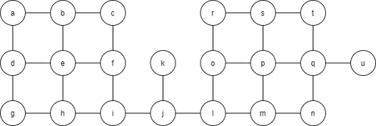

Now consider the traversal j-k-l-m-p-s-r-o-t-q-u-n-i-f-e-d-a-b-c-g-h, which has a recursion depth of 8.
min depth dfs
