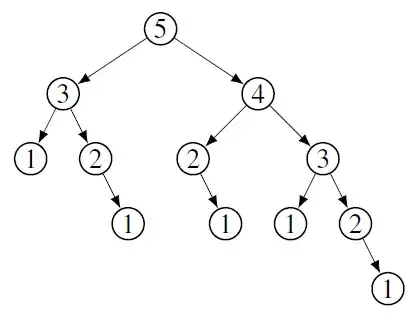

Now here is my question: Is is easy to argue that half of the levels of an AVL tree are completely filled? I am looking for a good argument that directly uses the definition of AVL trees, without the induction on the two subtrees.
Picture below has a Fibonacci tree with height 5 (counting the nodes) and three levels are completely filled.

Assume the node height of the AVL tree equals $h$. This shows that the longest path in the tree equals $h$: the node height of a node must be one larger than one of its children. Hence there is a path where the node heights step down by one.
Now for the shortest path length: the steps can at most be two. This follows from the fact that one child must one less in height than its parent. Then the other child must be at most two lees, as the AVL property dictates the heights of siblings differ by at most one. Thus the shortest path at most steps down by two. Hence half of the levels are completely filled. (With appropriate rounding.)
