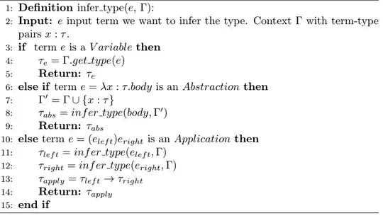

As far as I understand, this is the algorithm:
$$ \begin{algorithm} \caption{Type inference for Simply Typed Lambda Calculus} \begin{algorithmic}[1] \State{\textbf{Definition }infer\_type($e$, $\Gamma$)}: \State{\textbf{Input:} $e$ input term we want to infer the type. Context $\Gamma$ with term-type pairs $x:\tau$.} % \State {\textbf{match:} $e$ \textbf{with:}} \If{ term $e$ is a $Variable$} \State{ $\tau_e = \Gamma.get\_type(e)$ } \State{ \textbf{Return:} $\tau_e$ } \ElsIf{term $e = \lambda x: \tau. body$ is an $Abstraction$} \State{ $\Gamma' = \Gamma \cup \{ x: \tau \}$ } \State{ $\tau_{abs} = infer\_type(body, \Gamma' ) $ } \State{ \textbf{Return:} $\tau_{abs}$ } \Else{ term $e = (e_{left}) e_{right}$ is an $Application$ \textbf{then}} \State{ $\tau_{left} = infer\_type(e_{left}, \Gamma) $ } \State{ $\tau_{right} = infer\_type(e_{right}, \Gamma) $ } \State{ $\tau_{apply} = \tau_{left} \to \tau_{right}$ } \State{ \textbf{Return:} $\tau_{apply}$ } \EndIf \end{algorithmic} \end{algorithm} $$
(note couldn't get the latex to compile)
Which looks like you just traverse node in the tree once and then start constructing the desired type by using the correct constructors $Var, Apply, Abs$. So I'd guess in the format I am requesting the time complexity is:
- Input size is $n$ - the number of nodes in the tree term $e$
- $T(n) = O(n)$ linear, since we look at each node once.
I am assuming that getting the type for base variables takes $O(1)$ with hash tables/dictionaries. Adding one element to the typing environment/context is O(1) and it takes just as long to look for any size dictionary/hash table (so looking for more types in the context is fine).
Without hash tables it would take $O(n(V+n))$ in a very pessimistic analysis. For each look up at the leafs which we have $(n+1)/2$ we could do a linear search for the term we want so $O(V+n)$ where the +n comes from the worst case that we have always at most the number of elements in the context plus all the nodes we could have added when creating abstractions.
