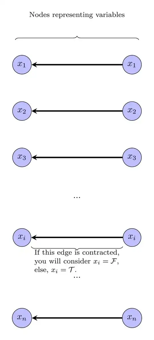

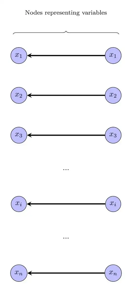

First we construct the graph as follows: for each $x_i \in \mathcal V$, we make two nodes, each labeled $x_i$, and a directed edge from one to the other (click images for high resolution view).
These nodes can of course be contracted, because they have the same label. We will consider variable/nodes that are contracted to be valued as false, and those that are uncontracted to be valued as true:

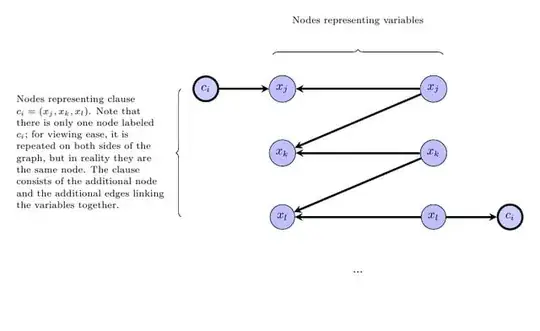

After this step, $V'$ should contain $2\cdot \left|\mathcal V\right|$ nodes. Next, we introduce the clause constraints. For each clause, $c_i \in \mathcal C, ~ \left.c_i = (x_j \vee x_k \vee x_l) \right|_{x_j,x_k,x_l \in \mathcal V}$, we introduce one node $c_i$, and the following edges:
Note the duplicatation of $c_i$ is for viewing purposes only; there is only $1$ node labeled $c_i$. (click image for full view)
After this step, we should have $2\cdot \left|\mathcal V\right| + |\mathcal C|$ nodes.
Now, if $x_i$, $x_j$ and $x_k$ get contracted, $c_i \rightarrow c_i$ will result in a cycle.

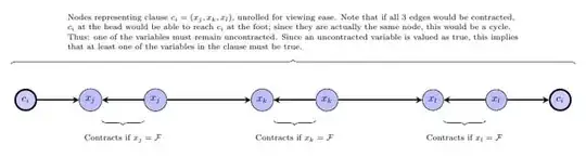

Here is another visualization, unrolling the clause constraint:
Thus, each clause constraint requires that at least one of the variables it contains remain uncontracted; since the uncontracted nodes are valued as true, this requires that one of the variables be true; exactly what Monotone SAT requires for its clauses.
