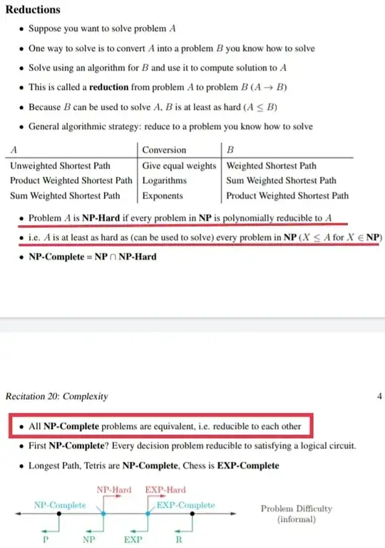

enter image description here From MIT lecture 2020 on complexity classes, you can watch from min44 https://youtu.be/JbafQJx1CIA
I understand that other answers address the question from the Theory of Computation point of view not from Algorithms Design & Analysis; however I still believe, at least from my view, that it's different in meaning whether they're (NP) each independently polynomial reducible to an easy instance of an NP-Hard problem or to each other, only NPC problems have that property otherwise why stated separately???
