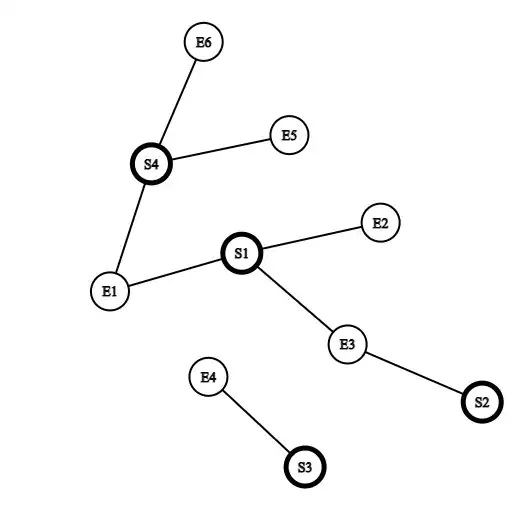

I have a graph containing selectors and elements. An element can have multiple selectors associated with it. As a graph, it looks something like this:
Graph
In the example, any node prefixed with an S is a selector and any node prefixed with an E is an element.
As you can see, elements can only connect with selectors. No elements will be connected with elements and no selectors will be connected to other selectors.

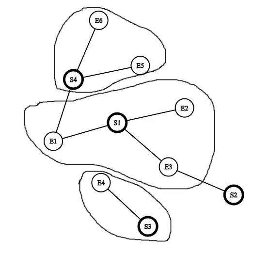

I want to choose the minimum number of selectors such that their neighbors include every element in the graph. In the above example, I would want my algorithm to return S1, S3, S4. However, I don't need to return the groups that they represent. I only want the selectors This is illustrated below:
Grouped Graph
In the example, we do not need to use the S2 selector as it is redundant. Furthermore, even though E1 occurs in both S4 and S1, we still need to include S4 because of the E5 and E6 nodes. In other words, these groups do not need to be exact covers and can overlap if necessary.

Your problem can be equivalently stated as a set cover problem. The universal set $U$ is composed of all elements $e_1,\dotsc,e_n$. For every node $s_i$ define a subset $S_i$ of $U$ that contains the elements it is connected to. For example: $S_{1} = \{e_1,e_2,e_3\}$ from the the example given in the question. Let $\mathcal{C}$ be the collection of all such subsets. Now, the task is to pick the minimum number of subsets whose union gives the set $U$.
The best possible polynomial-time algorithm for the set cover problem is the greedy algorithm only. It the same as the one you mentioned in your question. It gives $\Theta(\log n)$-approximation guarantee. Note that it is $\mathsf{NP}$-hard to approximate set cover with better than $\log n$ factor (see this). So this is the best possible approximation guarantee that you can achieve.
