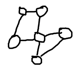

For example, with this graph:
a cycle of 4 vertices, sharing 1 vertex with a cycle of 3 vertices

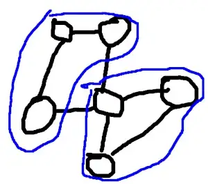

and $k=3$, $n=2$, here is a solution (in fact it's the only one):
the vertices in the 3-cycle are grouped together, and so are the remaining 3 vertices

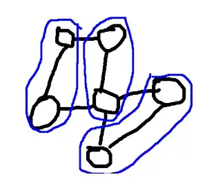

And here's one of the two possible solutions for the same graph with $k = 2$ and $n = 3$:
two pairs of vertices in the 4-cycle are grouped together, as are the remaining 2 vertices

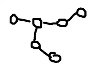

Sometimes this is not possible, like with this graph, for $k = 3$ and $n = 2$:
a path of 4 vertices, with a path of 2 vertices coming out of the second vertex
