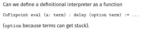

But since at least a decade, Xavier Leroy (perhaps among others? Not exactly my area of expertise, I'm afraid) popularised a coinductive definition of the operational semantics. I find these slides quite approachable. He defines Capretta's coinductive delay monad
Capreatta's coinductive delay monad
and then he asks
Yes, we can, as he shows us, by only doing small, incremental steps before each now or later constructor (productivity). That is quite like a trace produced by a small-step operational semantics; indeed the type of potentially infinite traces can be regarded as a concretisation/elaboration of the delay type. A diverging program would simply produce an infinite sequence of later (later ( ... )), a well-defined mathematical object.
Now that we have at our hands a function definition of a Turing-complete programming language's semantics that is totally defined as a mathematical function, we can reason about it in proofs and theorem provers such as Coq.
All this does not imply that there is a total (in the unfortunate sense that it diverges nowhere) function program halts : term -> bool that we can define in terms of eval; for that we'd need some worker function that keeps on eating later constructors from the result of eval until it finds a now; and that might take an infinite amount of time (when a now never happens). Of course, such a definition will not yield a total definition either, because it will not be guarded recursive in the delay (option term), so you wouldn't be able to define halts in the total fragment of Coq.
