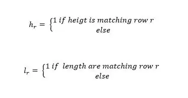

Next step is to create two other boolean variables, one for, wenn the height is matching row r, and one for the length:
So when both of them are 1, y_r is also 1:
But how do i create constraints that can switch h_r and l_r to 1 if they are fitting the row r ?
I found a smiliar question here, but its not quite it. I´m not sure, if I have upper and lower bonds and what they are if so.
