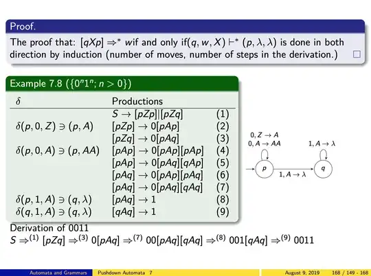

I am trying to understand this example of converting PDA to CFG but I am not getting the idea quite right. I do have the general understanding of theorem that if $p,q\ \epsilon\ Q $ and $X \varepsilon\ \Gamma$ for $[pXq]$ we have include the sequence of derivations which would pop X from the stack.
I partially understand what is going on but I cannot seem to understand how do I unroll the productions to form strings so I can understand it clearly. Take the production (5) in the example for instance. From what I understand it we are in state p we want to pop A and in the end we should be in state p with empty stack. As we are reading 0 we have zero in the production followed by $[pAq][qAp]$, this is the thing which I am not understanding because if we look at the PDA there is no way of going to q on reading 0. I would like to know what really is going on.

You have the basic intuition right. The variable $[p,A,q]$ represents the set of (strings accepted by) computations from state $p$ to state $q$ that will pop the topmost symbol $A$ from the stack.
Technicaly the relation between grammar $G$ and pda $M$ is given on the top of the slide you show.

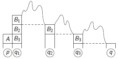

Then the construction follows recursion. If the pda pops $A$ but pushes $B_1B_2B3$ the grammar will replace the computation on $A$ starting in $p$ and ending in $q$ into three separate computations $[q_1,B_1,q_2][q_2,B_1,q_3][q_3,B_1,q]$. Here the intermediate states $q_2,q_3$ are unknown and are guessed by the grammar. Only $q_1$ is known, as it is the state where the pda instruction moves to.
Your observation is right. This standard construction might introduce triplets $[p,A,q]$ that will be useless. In your example there will be no computations from $q$ to $p$ so a triplet $[q,A,p]$ is never used in a succesful derivation. That is not problamatic. The construction just produces all possibilities, and variables that turn out to be useless can be removed afterwards if one really wants.
