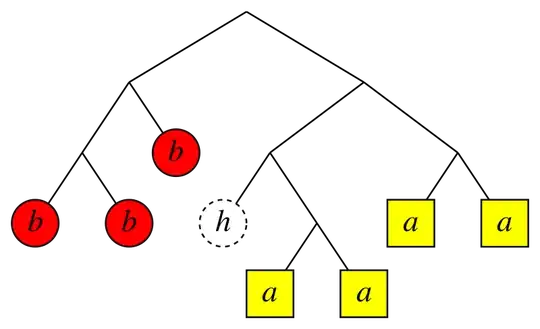

You can use regular expressions to define a kind of constraint on the types of the leaves of a data structure. The example pictured below is a binary tree which, when traversed from left to right, yields a sequence of elements of type b, followed by a leaf with no data, followed by leaves of type a. We can describe this with a regular expression like b*1a*. There is now a procedure for converting the original tree type, and the regular expression, into a tree type constrained by the regexp. A special case is the example of zippers.
You can read a bit about it here and a paper giving the details is Polynomial Functors Constrained by Regular Expressions.
Briefly: the transition matrix for the regular expression is reinterpreted as a bunch of "simultaneous" equations defining a collection of types through mutual recursion. For example, the tree pictured might be defined in Haskell like so:
data Tree11 a b  =  Leaf11 a
                 |  Fork11  (Tree12 a b)  (Tree11 a b)
                 |  Fork11' (Tree11 a b)  (Tree21 a b)
data Tree22 a b  =  Leaf22 b
                 |  Fork22  (Tree22 a b)  (Tree12 a b)
                 |  Fork22' (Tree21 a b)  (Tree22 a b)
data Tree21 a b  =  Fork21  (Tree22 a b)  (Tree11 a b)
                 |  Fork21' (Tree21 a b)  (Tree21 a b)
The three definitions here correspond to entries in the transition matrix of the finite state machine recognising b*1a*.
Dissected Tree
(By the way, this particular example can be thought of as representing the intermediate state of a recursive algorithm to walk the tree converting b's to a's. Normally in such a recursive algorithm, the stack "keeps track" of where you are. But by making your current state explicit like this it allows you to remove the dependence on the stack and rewrite the algorithm with tail-recursion.)
