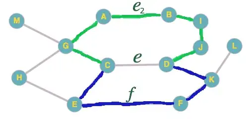

Consider an arbitrary edge $f$ of $G$. Let $\mathcal C$ be the cycle created when we add $f$ to $T_2$.

  • Otherwise, $f$ connects one vertex in $G_a$ and one vertex in $G_b$. $\mathcal C$, as a cycle, must include $e_2$ since $e_2$ is the only edge in $T_2$ that connect $G_a$ and $G_b$.
    In the above illustration, all green edges together with $e$ is the cycle created when $e_2$ is added to $T$. All blue edges together with $e$ is the cycle created when $f$ is added to $T$. All green and blue edges together is $\mathcal C$.
    Since $T$ is a local-MST w.r.t $w_1$, $e_2$ weighs the heaviest on the green cycle w.r.t. $w_1$. Since $w_2$ and $w_1$ agrees except on $e$, $$w_2(e_2)\ge w_2(\text{every green edge}).$$
    Similarlyly we have
    $$w_2(f)\ge w_2(\text{every blue edge}).$$
    Since $w_2(f)\ge w_2(e_2)$ by the specification of the algorithm, $f$ weighs the heaviest among all green edges and all green edges. That is, $f$ weighs the heaviest in $\mathcal C$ w.r.t. $w_2$.
    There are configurations other than the illustration. For example, $e_2$ or $f$ might be the same as $e$. The green cycle and the blue cycle might have multiple overlapping segments. In every case, similar argument with the same inequalities shows that $f$ weighs the heaviest in $\mathcal C$ w.r.t. $w_2$.
