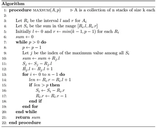

The algorithm
I came up with the following algorithm.
The idea is to calculate the best possible sum for each stack if all $p$ elements were chosen from that particular stack. This sum only considers the integers that can possibly be taken.
Then, greedily take the top element from the stack with the best possible sum. And update the sum for all stacks because now only $p-1$ integers need to be popped.
The question
is this algorithm always going to produce a correct answer? If not, when would this fail?

Here is a counterexample, with $p = 2$:
  • stack 1: $600,600$.
  • stack 2: $1000,0$.
  • stack 3: $1000,0$.
Your algorithm will choose the top element from stack 1 and one of the top elements from the other stacks, but it is better to choose the top elements of stack 2 and stack 3.
Disclaimer: This is based on your description of the algorithm. I don't understand some of the notation in the algorithm itself.
