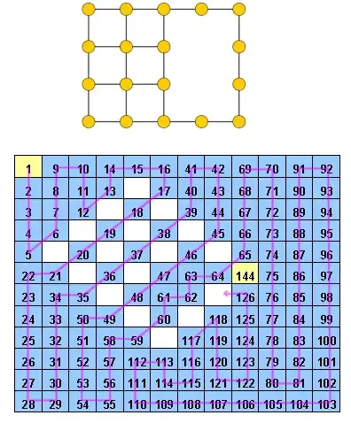

I think it is $\sf{NP}$-complete: as noticed by Raphael, Hamiltonian cycle on grid graphs with holes problem is NP-complete (Alon Itai, Christos H. Papadimitriou, Jayme Luiz Szwarcfiter: Hamilton Paths in Grid Graphs. SIAM J. Comput. 11(4): 676-686 (1982)).
So given a grid graph $G$ with holes, you can easily build an equivalent Hidoku game where the initial fixed cells fill all the even diagonals; the empty odd diagonals form an undirected graph that is equivalent to the original grid graph $G$ and the Hidoku has a solution if and only if the original grid graph has an Hamiltonian path.
Figure 1: a grid graph with holes and the equivalent $12 \times 12$ Hidoku puzzle (blue cells represent the initial fixed numbered cells ($1$ is the first, $144$ is the last), white cells are the cells that the player must fill, purple line indicates the sequence of the initial fixed numbered cells).
Auxiliary (filled) lines can be added to the bottom or right side to make it a square.

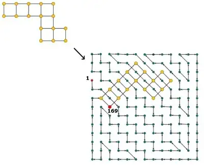

Another example of reduction from a grid graph to an Hidoku puzzle: the 6x4 grid graph is embedded in a larger 13x13 grid; the even diagonals are filled with fixed numbers, and the remaining free cells are equivalent to the original grid graph.
The full picture with transformation can be downloaded here.
