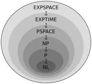

Generally speaking, the following is true for any algorithm:
  1. Suppose $A$ is an algorithm that runs in $f(n)$ time. Then $A$ could not take more than $f(n)$ space, since writing $f(n)$ bits requires $f(n)$ time.
  2. Suppose $A$ is an algorithm that requires $f(n)$ space. Then in $2^{f(n)}$ time, $A$ can visit each of its different states, therefore can gain nothing by running more than $2^{f(n)}$ time.
It follows that:
$\mathbf{NP}$ $\subseteq \mathbf{PSPACE}$
The statemement is known as part of the relations between the classes, as depicted by the following diagram:
relations between classes
The explanation is simple: a problem $Q$ $\in$ $\mathbf{NP}$ has a polynomial length certificate $y$. An algorithm that tests all possible certificates is an algorithm that decides $Q$ in time $\large 2^{n^{O(1)}}$.
Its space requirement is:
  • $y$ (polynomial in $n$)
  • space required to verify $y$. Since $y$ is a polynomial certificate, it can be verified in polynomial time, hence cannot possibly require more than polynomial space.
Since the sum of two polynomials is also a polynomial, $Q$ can be decided with polynomial space.
