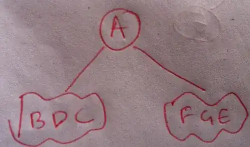

  • From POST order it is clear that A is root. So in IN order, I consider everything right to A is at it's right sub tree & so for left.

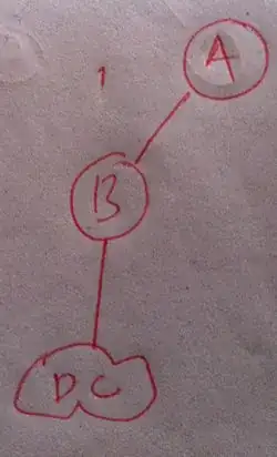

  • Now, I consider A's left sub tree. It has BDC. Again from POST order, I conclude that B is root.
  • Now, again consider B's sub tree. It has contents DC & POST order, C has to be at root. So now I get C at root. But where to place C, at B's left or right ? It's where I am getting stuck now.

In the example you start with postorder DCBGFE A and inorder BDC A FGE.
Using postorder you determine the root as A, and using inorder split the letters into left BDC and FGE. Thus (1) the left subtree has postorder DCB and inorder BDC while (2) the right subtree has postorder GFE and inorder FGE.
Let us look at left subtree (1) which you mention in your question. The root is B, and both DC follow to B in the inorder and thus are right from B. How to place them. This tiny subtree has postorder DC and inorder DC. Hence its root is C, and D is before C in the inorder, and is in the left subtree of C.
