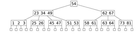

There is a lot of information online on this specific topic, but I still don't quite understand how to delete elements from a B-tree.
For example, given the following tree, how would we delete 26 and 63? enter image description here
Is there a general approach?

B-tree deletion tends to be explained very badly in most textbooks, because the algorithm has one particular case which is complicated.
When inserting a leaf element in a B-tree, if a node becomes over-full, you split it. This has the effect of inserting a node into to its parent. If that node then becomes over-full, continue recursively.
When deleting a leaf element in a B-tree, if the node becomes under-full, you conceptually merge it with one of its neighbours and the common parent element. This "merge" (or "rotation") operation is the key to understanding B-tree deletion.
Let's take deleting 26 as our example. This leaves us with a node containing just 25, which is under-full.
Suppose you merged the node with its right neighbour and its common parent. This would leave you with a node containing the elements 26, 34, 45, 27, with the element 34 removed from the parent. This is exactly the same situation you would be in if you had a leaf node which contained three elements and added a fourth, leaving the node over-full. So just do what you would do if this were an insertion.
It's a similar story if you delete an interior element. Suppose you deleted the element 34. Then all you do is merge the two child nodes that it affects, giving you a node with the elements 25, 26, 45, and 47. This is exactly the situation you'd be in if you had a node with three elements and inserted a fourth.
In practice, you don't actually "merge", but you "rotate" elements between child nodes and the new common parent entry. "Merging" only happens if there is no way to "rotate" without one of the new nodes remaining under-full.
Assuming the usual B-tree variant, a node can store between $t-1$ and $2t-1$ entries, where $t$ is the minimum ply of the tree. If you need to merge, it's because an entry was deleted, either from one of the nodes being merged or its common parent. Either way, you have $2t-2$ entries that you have to deal with. The solution is to just make it one node, which has the effect of deleting a node from the parent node. You can now simply delete recursively.
Some care needs to be taken with the root node, because deleting from the root node may result in the height of the tree changing.

All of the keys you want to delete in this particular example belong to the case when we are deleting keys from a leaf node, without need to rebalance a tree after deletion.
Algorithm for deleting a key from a leaf node consists of three steps:
1) Search for the value to delete.
2) If the value is in a leaf node, simply delete it from the node, because there are no subtrees to worry about.
3) If underflow happens (i.e., if we break one of the defining rules/properties of a B-tree - every non-root node has to have at least (M-1)/2 keys), rebalance the tree.
