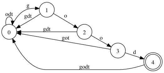

Searching Problem The DFA used in searching regex good could be:
1 matching:  "good"
2 matchings: "people do not give good comments are not good people"
Here are the questions:
  1. In the above two problems, it seems the searching problem's DFA is the matching problem's DFA plus some backedges and an additional state (here state 0). Is this the difference in general?
  2. What is the regex of searching problem in this case?

This is true in general, in a way. Consider a regex $r$. You can construct a DFA (or NFA) for the matching problem. Denote this NFA by $A$.
To solve the searching problem, you can proceed in several ways. First, you can just solve the matching problem for the regex $\Sigma^*\cdot r\cdot \Sigma^*$.
Alternatively, you can construct an equivalent NFA for the latter regex. The form of such an NFA would be an initial state that guesses when $r$ starts (at which point there is a transition to the initial states of $A$), and every accepting state of $A$ moves to an accepting sink.
This NFA can be thought of as a generalization of the situation you describe. Indeed, when you determinize it, the equivalent DFA essentially tracks $r$, and whenever it fails the DFA "resets". This is not exact, since it strongly depends on $r$.
When $A$ is a chain, then indeed determinizing the NFA yields a DFA that follows the chain, and whenever there is a "mistake" (that is, $r$ is not met), it resets to the initial state. However, it could be that resetting might not go as far as the initial state. For example, when searching for $aba$, if you see $aa$, then the second $a$ should not reset all the way back, but rather to the second state, since the second $a$ may be the start of the regex's occurrence.
