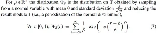

As far as I understood, in Regev's initial paper, the error distribution was first constructed as follows:

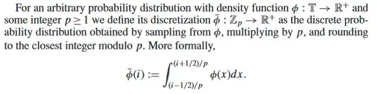

Then rounded in the following way:

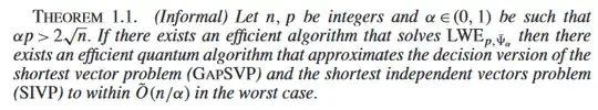

Using this distribution, the reduction in the theorem below can be achieved:
