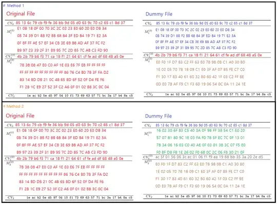

I have a source data A and a hash H(A) of this A. Is it possible by google's shattered docs to create a new data B that outputs this H(A)?
Method1,2
++ I understood that the content of the paper is to complement two message blocks so that the final CV is the same. The method I thought of is whether M2(2) of "Dummy File" can be properly found so that CV2 of "Original File" and "DummyFile" are output the same as in Method1 in the photo, or make only CV2 the same as in Method2 through find new M1(2), M2(2).
A 64-byte message block is meaningless data. Therefore, the file does not have to open normally.
The format of the file is not limited to PDF.
No. What you described would be a second pre-image attack, whereas the google team produced a collision attack. In the SHAttered "The first full collision on SHA1" paper by Mark Stevens et al. where those states are quoted in your method 1, the authors were first able to simultaneously select $M_1^{(1)}$ and $M_1^{(2)}$ making slight perturbations to one or the other until a close pair of values $CV_1^{(1)}$ and $CV_1^{(2)}$ were produced. In your scenario $M_1^{(1)}$ would be fixed and only $M_1^{(2)}$ could be adjusted making it much harder to find close $CV_1$ values. Likewise, in the second step the researchers were able to perturb both $M_2^{(1)}$ and $M_2^{(2)}$ to find the full collision, but in your scenario an attacker would only be able to adjust $M_2^{(2)}$.
The difference in difficulty of these challenge is such that finding a second pre-image for SHA1 is still likely to take roughly $2^{160}$ hash function evaluations. It is akin to the difference between the probability of finding two people in the room with same birthday and the probability of finding someone in a room with the same birthday as you.
More recent work ("SHA1 is a shambles" by Leurent and Peyrin) shows that it is possible for an attacker to take an arbitrary file and append data that they control both to your file and theirs in such a way as to produce the same SHA1 value for both files. This is known as a chosen prefix-collision and is still stronger evidence that SHA1 needs to be deprecated.
NB: Your table of byte values labels both left and right as $M_1^{(2)}$ and I've reverted to the notation of the SHAttered paper. I'm not sure of the source of your second table.

the (principle) of the paper is to complement two message blocks
Not exactly. It's complemented some few bits in two consecutive message blocks (64 byte each), which content is chosen (with sizable but feasible work) as a function of the hash state before processing these two message block. Therefore the content of these two messages blocks in A is not arbitrary, it must match these painfully computed 128 bytes. Such match won't happen by accident (e.g. for random A), it requires some control on A, and knowledge of the state of the hash before hashing these two blocks. Such knowledge can be obtained by knowing the part of message A before these two blocks of A one must choose to make the attack work.
