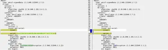

But for production we don't use openssl but PrimeKey Signserver (which is based on bouncycastle) with CMS signer. Here I was not able to configure the CMS signer to generate a working PKCS#7 so far. The problem is a difference in digest_enc_algorithm as seen in the image below (Left: signserver, right: openssl).

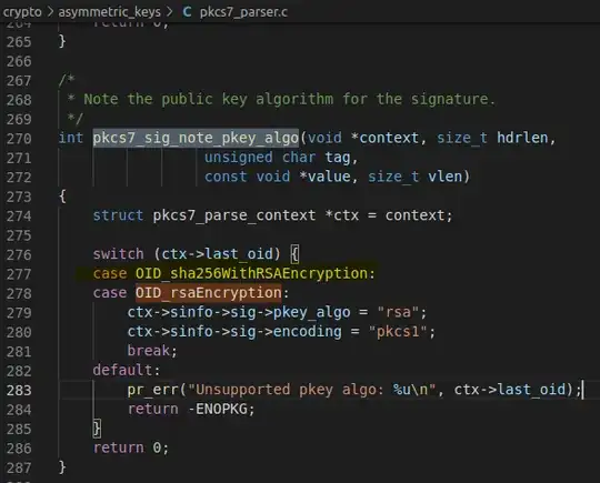

The problem is, that the kernel wont support that OID. Simply adding the sha256WithRsaEncryption to the switch fixes the problem, but I am not sure if this is a valid solution. Kernel fix
Another "fix" I found was simply replacing the OID of the signed PKCS#7 file, which also raises a few questions for me?!

  • Is there a real difference between rsaEncryption and sha256WithRsaEncryption in that context?
  • Why is it possible to alter the PKCS#7 file and everything works fine?
  • Would it be a valid fix to add the OID in the switch-case in the kernel? (at least from a crypto perspective)
