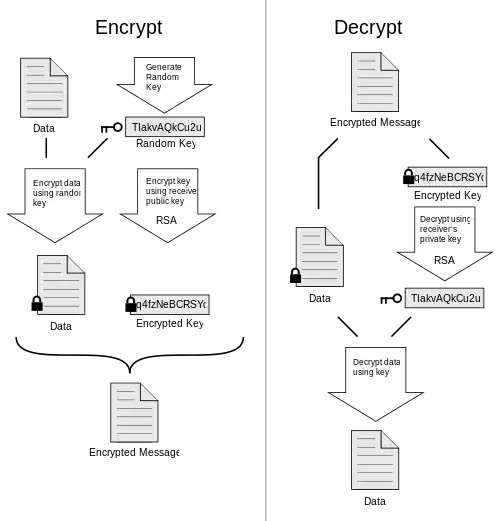

Have a look at the wikipedia image from the PGP article. The magic behind how the whole thing works is through the RSA algorithm.
Let's say Alice wants to send an encrypted message to Bob. Bob generates a public and private key pair. How the key generation process works is through a whole bunch of mathematics.
Essentially, this is how RSA works.
  1. Chose two large and distinct primes, $p$ and $q$.
  2. Compute $n = pq$
  3. Chose the public exponent, $e$. This is $65537$ by tradition.
  4. Compute $\varphi(n) = \varphi(p)\varphi(q) = (p − 1)(q − 1)$, where $\varphi$ is Euler's totient function.
  5. Compute $d$ such that $d$ is that multiplicative inverse of $e$ (modulo $\varphi(n)$).
The public key consists of $n$ and $e$ while the private key consists of $n$ and $d$. It is very difficult to derive the private key from the public key because prime factorization is a difficult problem.
The actual encryption of the data is done using a symmetric cipher and a completely random key. Alice then encrypts the random key with the RSA public key belonging to Bob and the encrypted key as well as the encrypted data is sent to Bob.
Bob decrypts the encrypted key using his private key and then decrypts the encrypted message with the decrypted key.
How Alice can be confident that she is using the public key belonging to Bob is a completely different problem involving complicated stuff like a web of trust.
