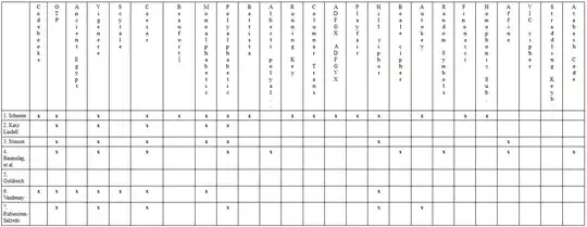

As another way to answer the question, I looked at several introductory university-level textbooks to see what topics they covered vis-à-vis classical cryptography. Monoalphabetic and polyalphabetic refer to general discussion:
