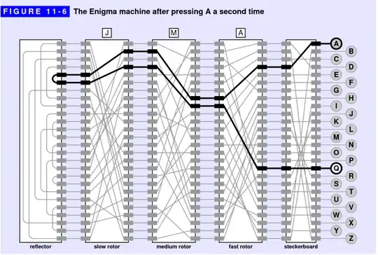

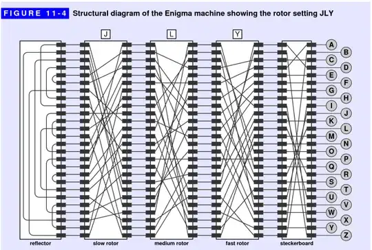

I think the steps on these images will remove your confusion. Concentrate on the fast rotor and remember that only 3 rotors are rotating, the other 2 permutations are fixed - reflector and steckerboard.
Now, press $A$ on the keyboard and see the path. Watch the connections and the status of the fast rotor.
After this, the fast rotor will advance ( if necessary the medium and slow, too, here only medium and fast) and the re-entering $A$ will follow the below path.
The curial points are those;
  • after a keypress, the permutation changes. Notice how the slow motor moves up and the wirings follow.
  • The letter of the rotors indicates the position. At each point, the connection to the next rotor is kept ( the straight lines with bold connector).
  • The internal wirings ( permutation ) changes the input and output at each step. There are 26 possible permutations for a rotor. This is the way Enigma confuse the data. Select a different permutation for every input. That is, however, is not enough to be secure.
