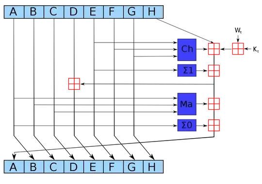

For example, the math for SHA256 is
  • $\operatorname{Ch}(E,F,G) = (E \land F) \oplus (\neg E \land G)$
  • $\operatorname{Ma}(A,B,C) = (A \land B) \oplus (A \land C) \oplus (B \land C)$
  • $\Sigma_0(A) = (A\!\ggg\!2) \oplus (A\!\ggg\!13) \oplus (A\!\ggg\!22)$
  • $\Sigma_1(E) = (E\!\ggg\!6) \oplus (E\!\ggg\!11) \oplus (E\!\ggg\!25)$
The bitwise rotation uses different constants for SHA-512. The given numbers are for SHA-256.
The red $\boxplus$ mean $ c = a + b \mod 2^{32}$, i.e. modulo addition.
As we can see, simple operations that CPUs can handle, light round function, with a little degraded unbalanced Feistel structure.
