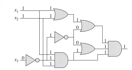

Problem should be in NP class. NP problems are problems that there exists an (efficient) algorithm that can decide or prove in polynomial time that is w a witness for the statement s (their statements) or it isn't. Many of zkSNARKs are based on circuit satisfiability problem. Circuit satisfiability is a NP-complete problem. There are two types of circuits: boolean and arithmetic circuits that can be converted to each other. Roughly speaking, we can design circuits for all algorithms (ex. SHA-256) that we can run on our computer. The below picture is a simple boolean circuit consist of wires and logic gates (AND, OR and NOT). In a zkSNARK system based on this simple circuit, prover want to convince the verifier that he knows the inputs ($x_1$ = 1, $x_2$ = 1, $x_3$= 0) that for this inputs the output of circuit is true, in another words, he knows the inputs that satisfy this circuit. enter image description here
