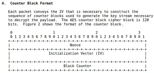

I want to use AES CTR with a random IV, as this would be the easiest way for me. I have a cryptographic module, that supports true random number generation. Due to compatibility, I must use AES CTR. The module also supports a monolithic counter, but its max value is quite low and might be too low for my use-case.
RFC 3686 states the following:
I must ensure that the IV never repeats, which is not true for a random number, as it could repeat. My key does not change. I found this thread on so that states, that using a random number (128 bit in this case) is an easy way to do it, as collisions are very unlikely.
My counter block would consist of only 64 bits of random (IV), 32 bytes would be reserved for the block counter, and 32 bytes for a static device identifier (Nonce). The generation of a new random IV would only occur on device restart and block counter overflow, both events occur rather rarely. This minimizes the possibility of a collision drastically, however, a chance remains.

There is no mention of random generation in this document it is an old document too. In AES-GCM NIST 800-38d, it is either random nonce or incremental nonce with counter/LFSR is advised, remember AES-GCM uses CTR mode with a combination of a 92-bit nonce 32-bit counter. 92-bit nonces are safer to use in random than 64 bit IVs since the collision probability is low.
We simply approximate the collision probability by the square root for 50%. Therefore we can say 64-bit random nonces have 50% collision probability after $2^{32}$ unifrom random nonce generation. Actually, in the adversary sense, this is not negligible one must stop way earlier. In the case of 96-bit, one needs to generate uniform random $2^{48}$ nonces to hit 50% and the same adversary approach should be taken. To see more detail about the collision see Birthday problem for cryptographic hashing, 101. by fgrieu.
  1. If not, do you think, that this approach is valid?
Since your key never changes there is a 50% collision probability after encrypting $2^{32}$ messages and you will hit the (key,IV) reuse problem, the more you encrypt the more you will have.
As I can see, your compatibility is CTR not how it is used. You can either use sequential IV as in GCM's suggestions that will enable you to encrypt up to $2^{64}$ messages under the key or remove the device identifier for the IV and use random generation under which you will get a collision with 50% probability after encrypting $2^{48}$ messages.
