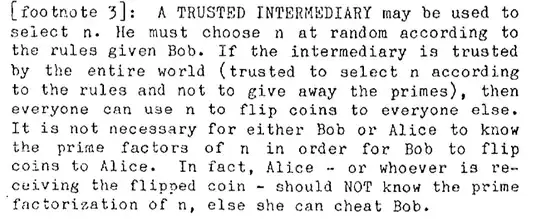

$n$ seems to be picked by Bob or a trusted third party:
TTP picks n
As Lindell already mentioned, the n is also tested by the other party.
