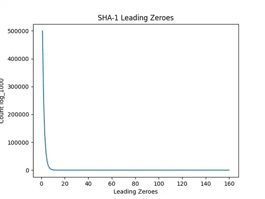

The graph of the event.
Note that it is possible to draw this together with $n/2^i$, however, they are so close to each other that one needs to zoom.

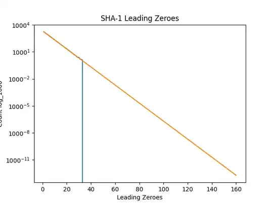

The below is the $\log_{1000}$ scaled $y$ axis with $10^{10} \approx 32$-bits random trials, 1K times more than above, took around 3 hours. With the result data
4999899716,2500040694,1250025163,625012247,312519435,156242195,78129201,39070485,19532263,9766270,4882962,2438565,1220675,610279,305021,152313,75950,38232,19141,9601,4800,2403,1200,610,305,127,75,32,16,15,4,3,2,0,0,...
This time the with $n/2^i$, which is reddish. Since the event is so small compared to space, most of the values are 0 that is the reason for the drop of blue.

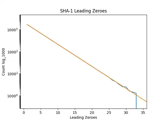

A zoom on the initial part is the below figure.
This tells us that how SHA-1 outputs are close to ideal. We already know that is necessary but not sufficient and the attacks on SHA-1 verifies this.
