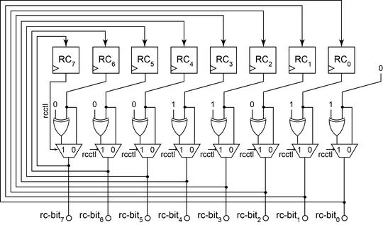

You can implement this in many ways. The naive approach that you'd have in class, but is easy to follow (also, FPGAs would do this generally):
The way that I generally do it (note, this is encryption, you move tap 4 for decryption):
The clock control increments the value.
