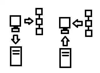

I've been toying around with a solution to this problem using blockchain tech.
Say for every client that wants to make a server request, they have to first record their request on a blockchain. Then that client would submit that same request to your server.
Your server would check that the received request also exists on the blockchain before processing the request.
Responses would work the same way but in reverse. The server would publish a response on the blockchain and sent a normal response to the client. The client could then check to make sure that the response from the server also exists on the blockchain.
Something like this
This is probably way overkill, but it's an interesting concept.
