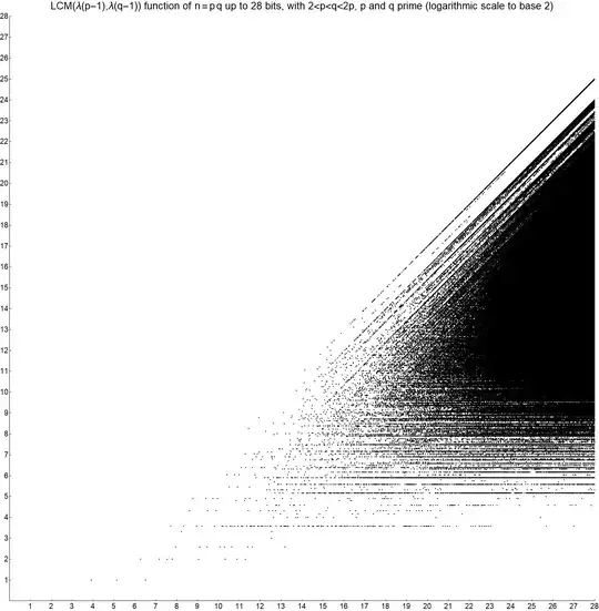

But why are short cycle relatively common for moderate $N$?
Define the decomposition of $p-1$ (resp. $q-1$) into prime factors to be $p-1=\prod p_i^{\alpha_i}$ (resp. $q-1=\prod q_i^{\beta_i}$). The order of any element of $\Bbb Z_{p-1}^*$ divides the Least Common Multiple of the $(p_i-1)\,p_i^{\alpha_i-1}$. Thus when iterating $E$, we always are back (though not necessarily first back) to the starting point after making a number of steps equal to the Least Common Multiple $\ell(N)$ of the $(p_i-1)\,p_i^{\alpha_i-1}$ and $(q_i-1)\,q_i^{\beta_i-1}$. I'm still trying to track the name of this $\ell(N)=\operatorname{lcm}(\lambda(p-1),\lambda(q-1))$ (where $\lambda$ is the Carmichael function used for computing the lowest possible private exponent $d=e^{-1}\bmod\lambda(N)$ in RSA, but here applied to $p-1$ and $q-1$).
Even without a name, it can be computed and graphed. ell(N) The $p_i-1$ and $q_i-1$ are composite (or $1$), which increases the potential for common factors. Due to this effect, $\ell(N)$ often ends up with sizably less bits than $N$. For a particular $e$, some further factors of $\ell(N)$ may disappear. This explains the phenomenon.
In our example $p-1=66=2\cdot3\cdot11$, $q-1=198=2\cdot3^2\cdot11$, thus $\lambda(p-1)=2\cdot5$, $\lambda(q-1)=2\cdot3\cdot5$, hence $\ell(N)=2\cdot3\cdot5=30$, and for any $e$ the maximum cycle length must be a divisor of that. It happens that the choice of $e$ further reduces that maximum cycle length to $5$.
