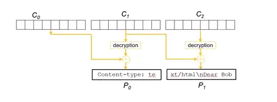

Here is a nice explanation from the efail presentation, credits to Jens and Chris! This is for CBC but it looks pretty much the same for CFB.

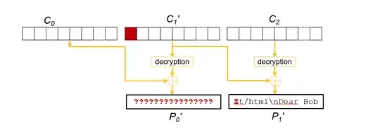

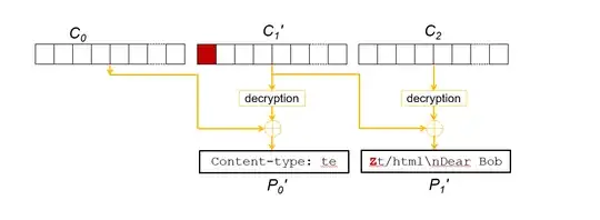

So here is CBC decryption: CBC decryption Now if you flip a bit in $C_1$ you can flip that same bit in $P_1$: flip a bit but it will also cause $P_0$ to look like random trash after decryption. other block gets destroyed

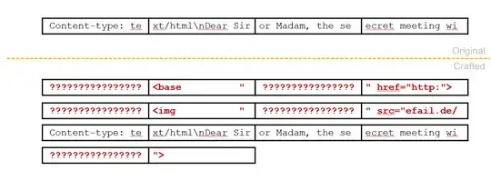

But if you know what $P_1$ was in the beginning you can basically XOR it with whatever you want and thus insert blocks into the decrypted plaintext at the cost of randomizing every other block. So the ciphertext is clearly malleable.
This can be exploited if the randomized blocks can be escaped somehow on the application level or similar. Again a picture from one of the efail presentations: full exploit Here the randomized blocks are ignored because they are put inside quotes and the HTML parser ignores quoted strings without an attribute name.
