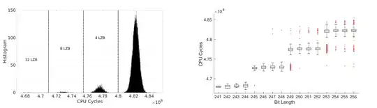

  • The timing measurement Normally Intel fTPMs Linux kernel driver uses command response buffer in push mode. The driver checks the status after 20 milliseconds, if the calculation is not ready, the driver re-checks. It doubles the time for every check. This driver doesn't allow a perfect timing measurement, therefore, the TPMfail team developed their kernel driver to perfectly measure the timing. They collected 40000 ECDSA signature. They similarly build a driver for STM's hardware TPM.
  • Timing Analysis: They discovered that a bit-by-bit scalar point multiplication implementation that skips the computation for the most significant zero bits of the nonce. Therefore nonces with more leading zero bits are computed faster in TPMs.
On the below figure it is Intel fTPM's timing histogram. On the right a nonce depended software implementation. Comparing the figures leads to the information that Intel used a 4-bit fixed window during Fixed Window Scalar Multiplication.
In the left figure, there are 4 regions, the fastest one has nonces with 12 most significant windows are zero, next has 8, next has 4, and the slowest region has none.

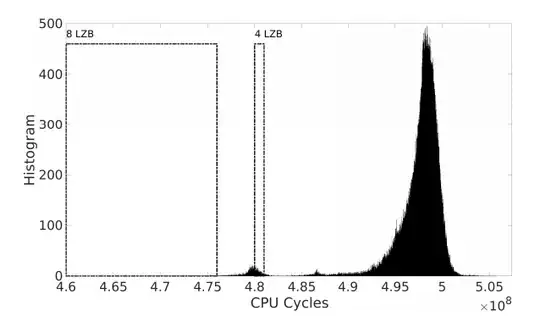

    STMicroelectronics TPM ECDSA Key Recovery
    They were able to recover the ECDSA key after 40,000 signature for 8-bit with 35 fastest signatures.
  • User level as before mentioned, in user-level the kernel driver checks the result, first in 20 micro seconds. This lead the below timing measure;
    They collected 219,000 signatures that contain noisy 855 8-bit leading zeros. With filtering, they get 53 high-quality signatures with 100% recovery rate. They also look for the 4-bit case.

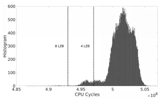

  • Remote adversary This is the weakest adversary in terms of capability. They set up a fast 1G network and requested 40,000 signatures to collect timing information. Although the timing histogram noisier, it still shows information about nonces with 4 and 8-bit leading zeroes. For the 4-bit case; 1,248 signatures are collected in less than 4 minutes and for the 8-bit case; the required signature is collected in 31 minutes.
They used this remote attack against StrongSwang, an open-source IPsec VPN implementation that is supported by modern OSes, including Linux and Microsoft Windows.
