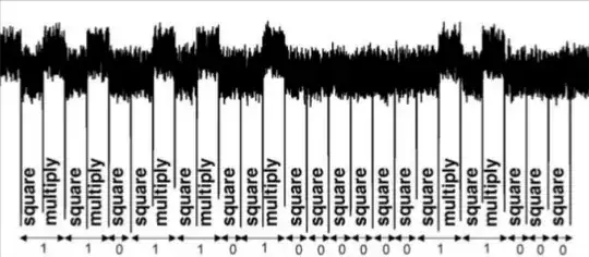

The if condition is an attack point for side-channel attacks. One can measure power usage and determine exponent bits. The below image or similar research images can show the idea of the attack.
If you are signing with RSA your private exponent can be revealed. Squaring can be implemented faster than multiplication, in that case, it can also be exploited. Therefore, you need constant timing to prevent this. The python library contains power modulus pow(a,e,n) which is based on repeated squaring and it is not secure. The below version of the repeated squaring method always calculates the (result * base) % MOD and discards it when it is not necessary. This may help mitigate the attack, however, this can be still traced if there is an instrument with enough resolution. Also, during compilation, make sure that this mitigation is not removed by compilers. Compilers, like Cray's CC can discard unused calculations as an optimization by default. The below algorithm has given a name as square and always multiply algorithm.
