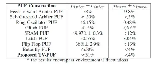

That said, the following table lists some tests for differing PUF constructs. Be aware though that they are not real. They're based on Monte Carlo simulations which obviously requires pseudo random inputs. The Flip-Flop PUF seems inefficient. The bottom entry for the TV-PUF is what the authors are proposing, at ~50%.

From: Saha, Sehwag, V-PUF:A Fast Lightweight Analog Physical Unclonable Function. Paper.
