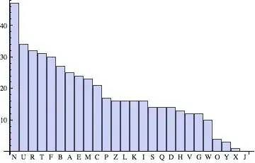

I also did a frequency analysis of the ciphertext:
Frequency analysis
It tells us two things: it resembles English text and there is no j. If you are familiar with the classical ciphers, there is one in particular that conflates i and j: the Playfair cipher.
This should be enough to get you started.
