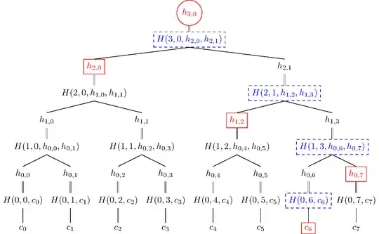

For example, in an eight-chunk file, when you transmit chunk $c_6$, send it alongside $h_{0,7}$, $h_{1,2}$, and $h_{2,0}$; the client, given the possibly modified $(c'_6, h'_{0,7}, h'_{1,2}, h'_{2,0})$, computes $h'_{0,6} = H(0, 6, c'_6)$, $h'_{1,3} = H(1, 3, h'_{0,6}, h'_{0,7})$, $h'_{2,1} = H(2, 1, h'_{1,2}, h'_{1,3})$, and $h'_{3,0} = H(3, 0, h'_{2,0}, h'_{2,1})$, and then verifies $h'_{3,0} \stackrel?= h_{3,0}$ before accepting the chunk $c'_6$ as genuine. The information needed to download and verify $c_6$ is illustrated in the diagram below:
  • The red solid boxes are data transmitted. Note that there is no need to download any other chunk to verify $c_6$—only three hashes are needed.
  • The blue dashed boxes are recomputed by the receiver.
  • The red solid circle is the root of the Merkle tree, i.e. the hash $h$ of the whole file, which is sent first on some channel assumed not to be corrupted, and which the receiver uses to verify each chunk.
Merkle tree with fanout 2, height 3, and total length 8
