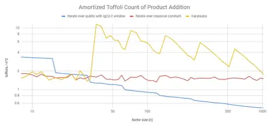

    Modular addition using these approximate representations are significantly more efficient than modular adders using the normal representation. For example, here is a comparison of the time*space of each addition when targeting a 0.1% total approximation error rate over the entire algorithm. The "runway" entries are the ones using the approximate representations. The runway entries are significantly better across the entire span of register sizes:
    cost of approximate adders
    These representations build on previous work by Zalka from 2006.
  2. "Windowed quantum arithmetic". Classically, if you know what constant you are going to multiply by when producing a physical multiplication circuit, you can specialize the circuit to that factor. This allows you to make the circuit smaller and more efficient. There is a quantum equivalent to this optimization, where the quantum program can be optimized using knowledge of the classical constant you are going to multiply by. We use this to make n-bit quantum-classical multiplication programs log(n) times shorter.
    windowed multiplication
    We then generalize the technique, apply it simultaneously to the exponentiation part of the circuit, and save another factor of log(n).
    This paper builds on previous work by R. Van Meter from 2005 (although we didn't actually know this when writing the paper, so it is not cited in the current version).
